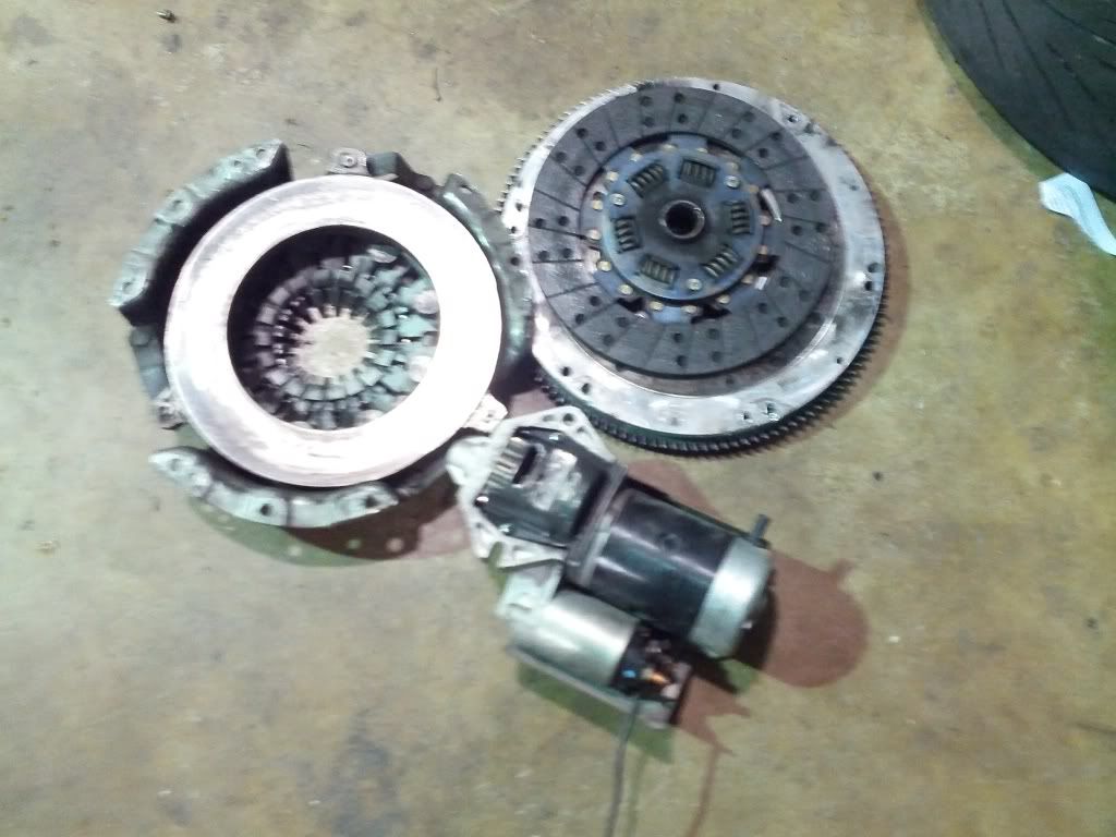

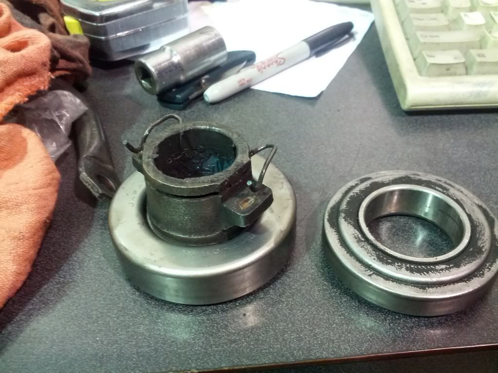

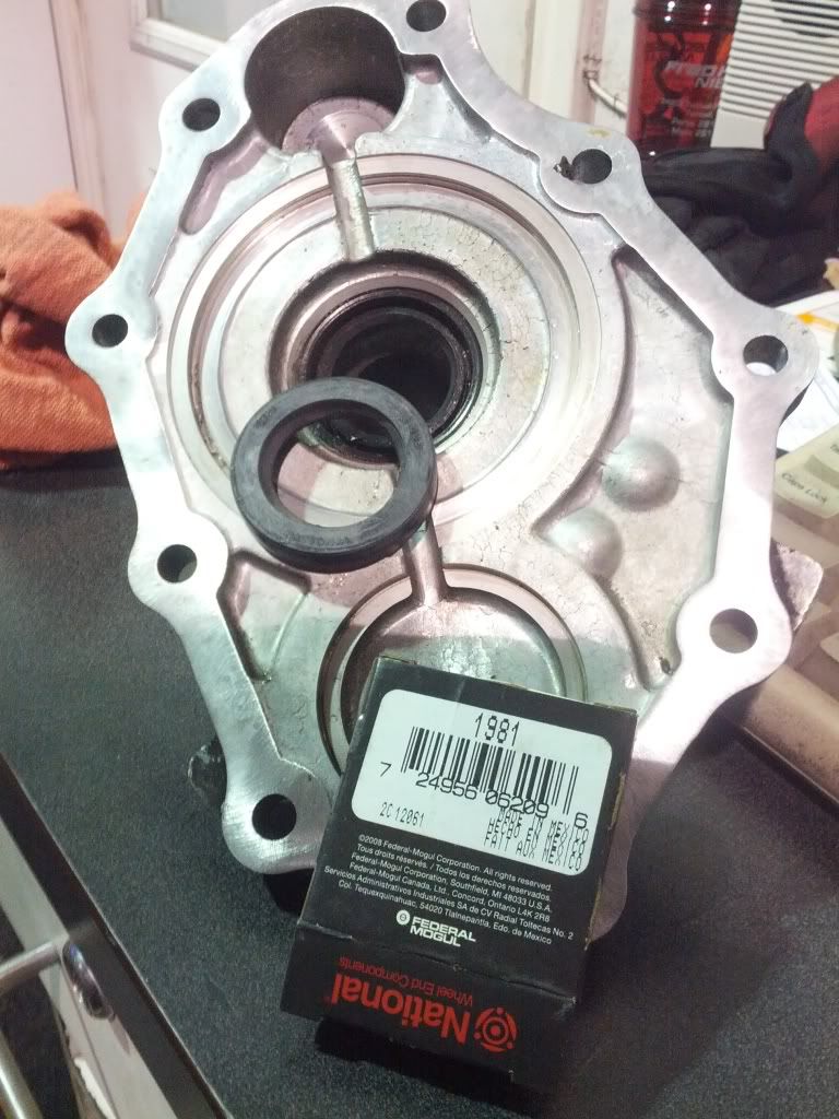

Message starter, TOB trans input shaft seal, ramey Z starter spacer, RP fluid.

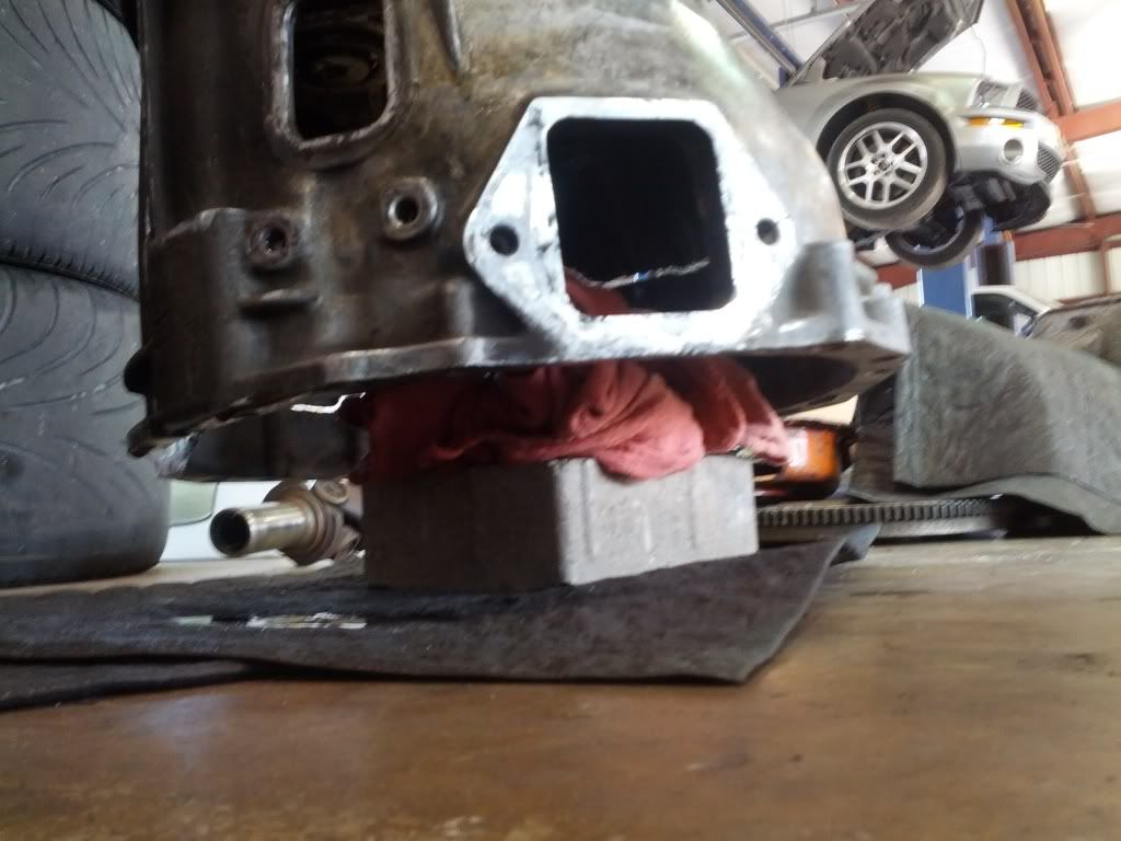

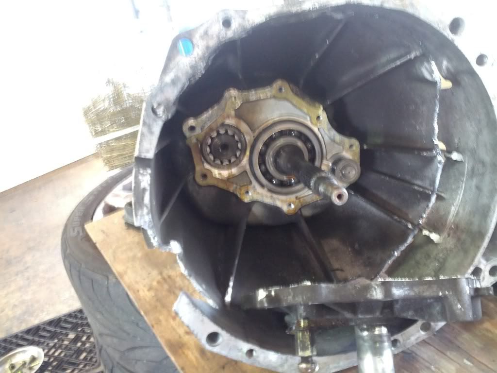

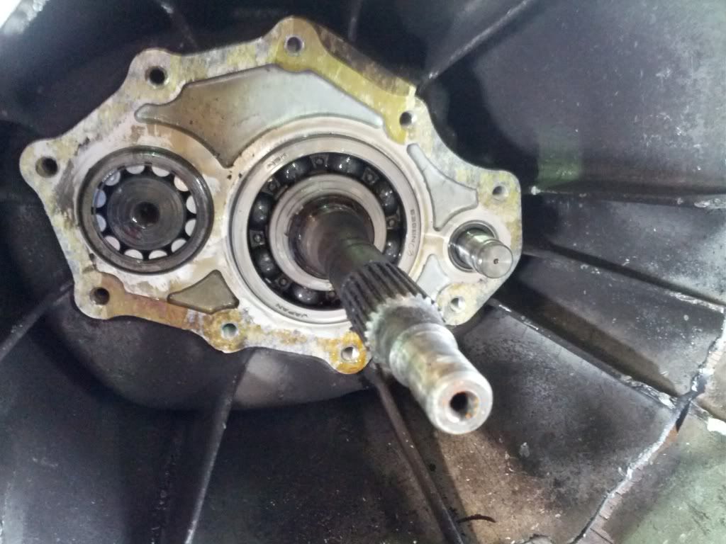

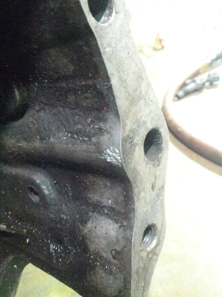

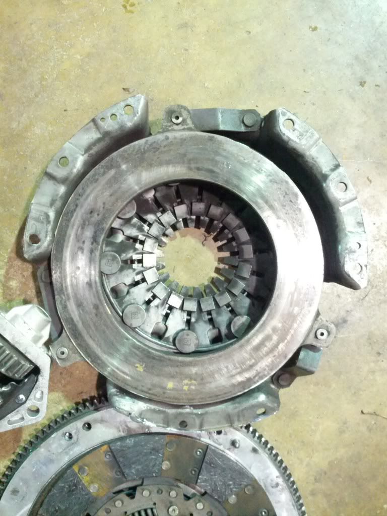

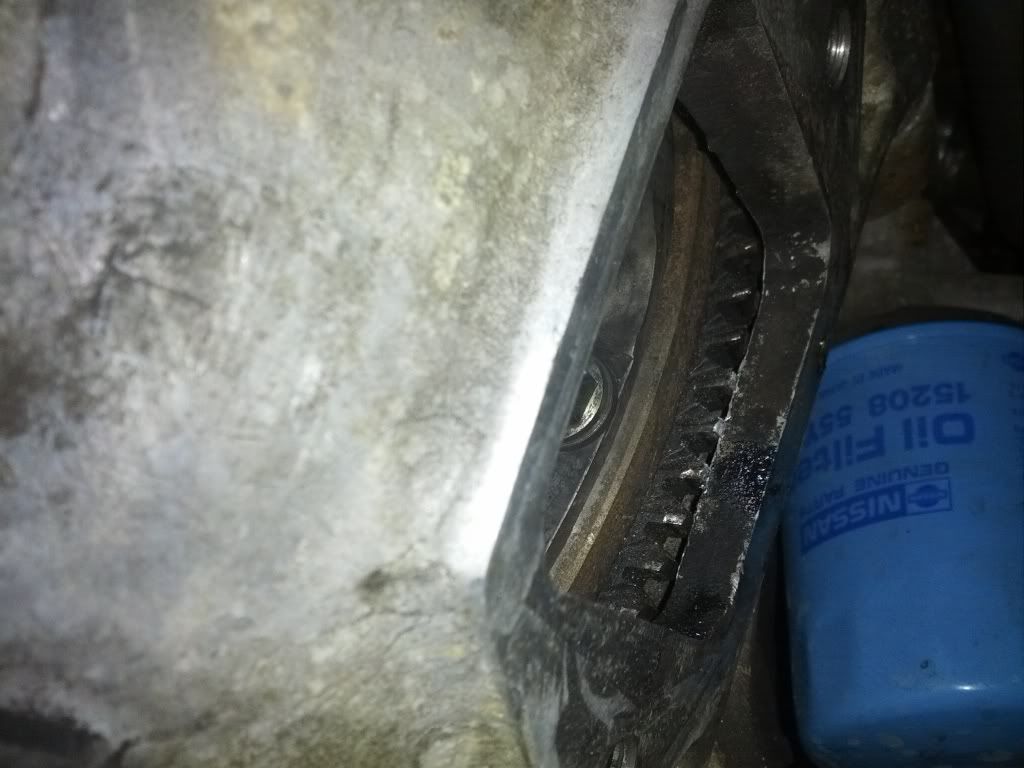

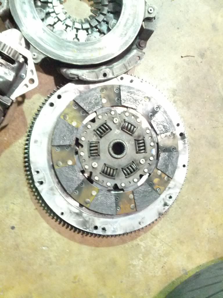

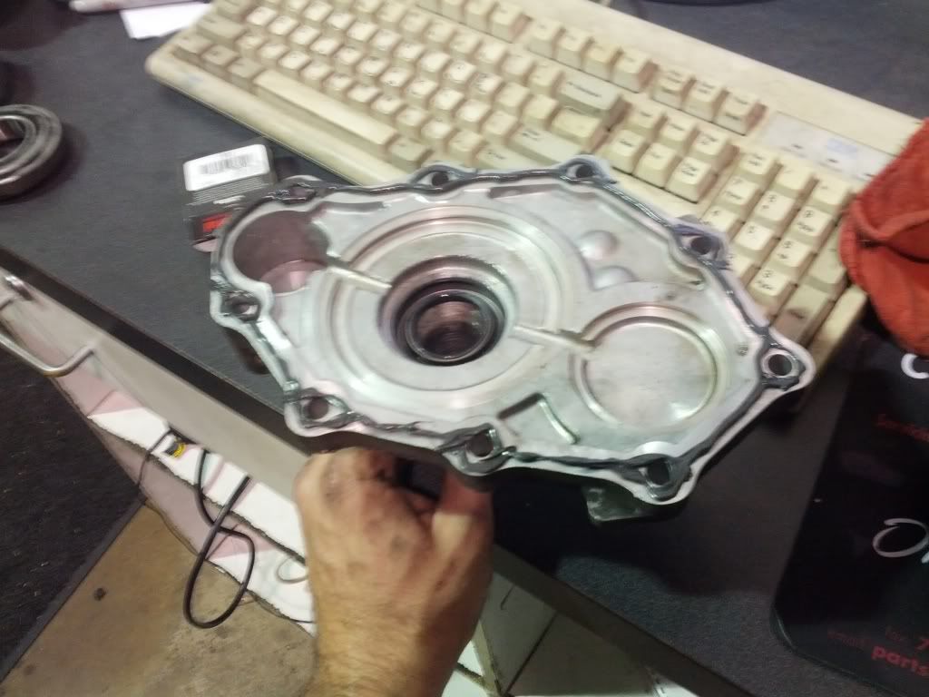

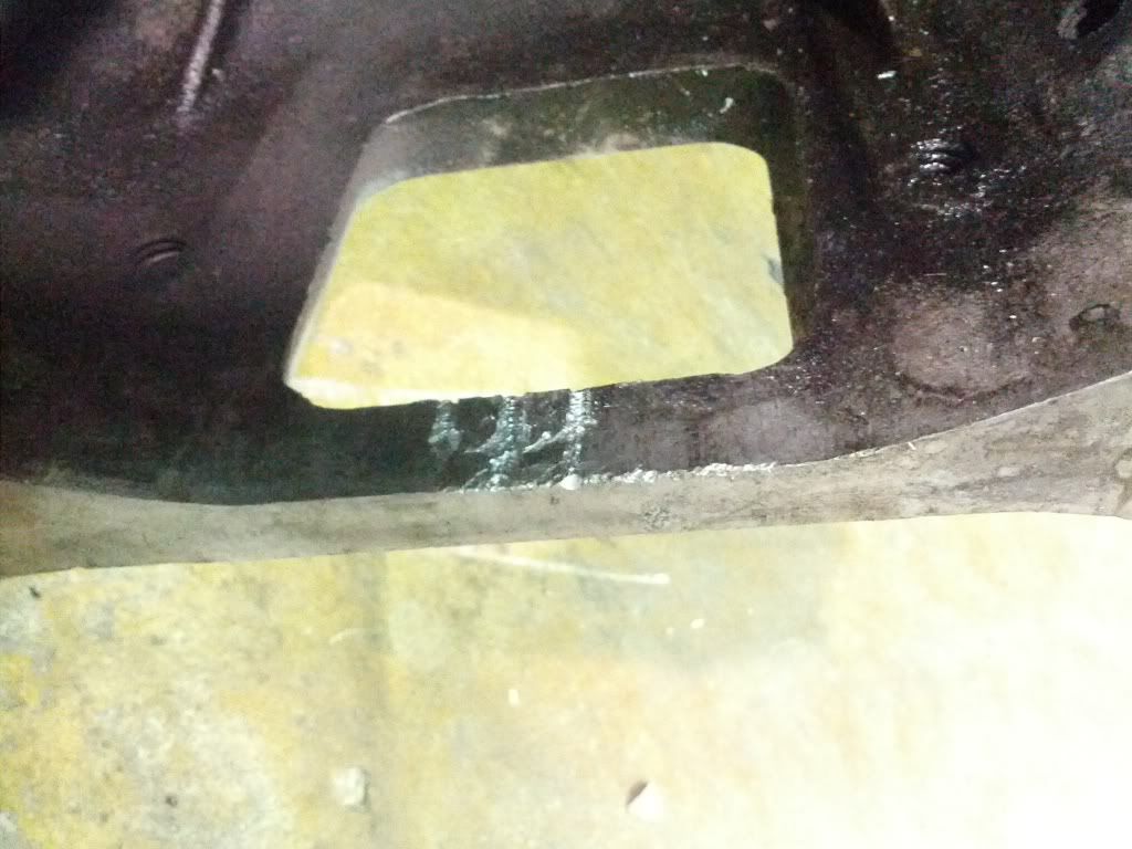

you can see i DID have to grind the inside bell house for a stock TT flywheel/ring gear, pictures to prove it. Well bell housing was off all syncos and synco clips visable on the front half were fine.

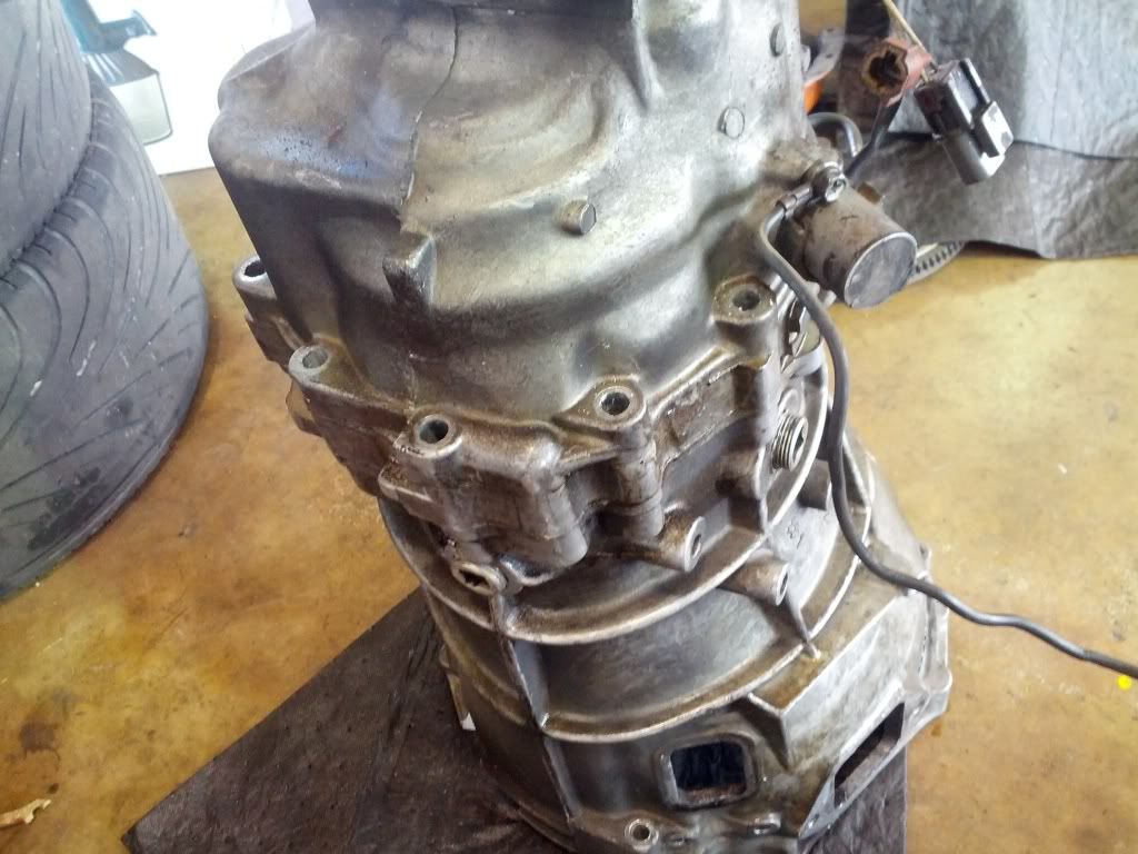

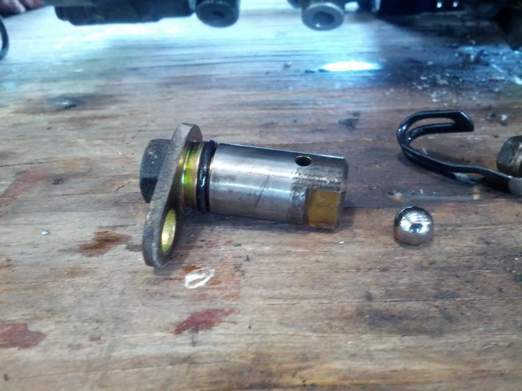

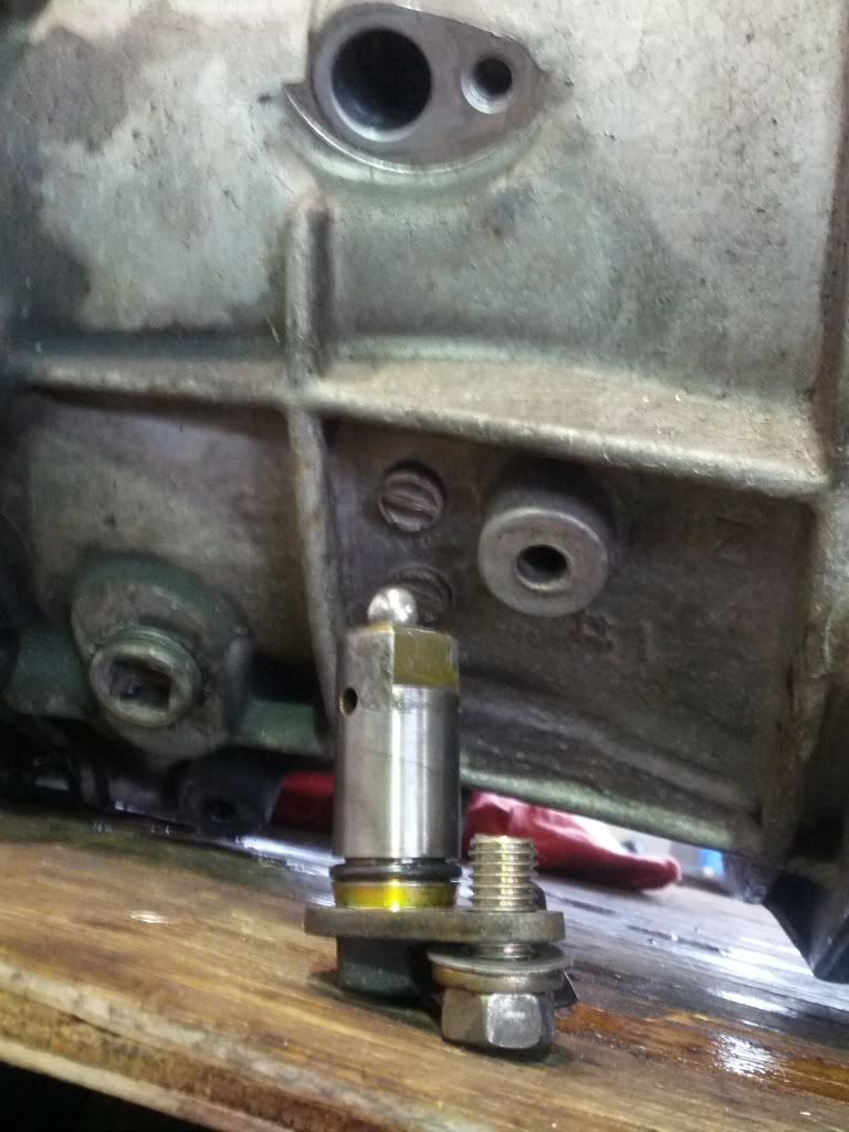

luckly everthing is happy trans still shifts fine. I tried to picture document the bell housing repair but said screw it and rushed it back together. them important part is the little check ball "interlock assembly " has to be removed vertical downward so the ball doesnt call in trans. that that it matters if yoyur pulling the front bellhousing.
